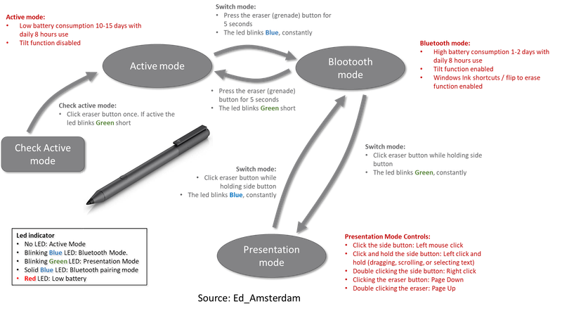

For anyone who's struggling the HP Tilt Pen I made a user manual, missing from HP. It describes how to check the battery status and how to switch from Active Mode to Bluetooth mode to Presentation mode and back. Hope its useful!Battery status.pngHP Tilt Pen instructions_2.png
