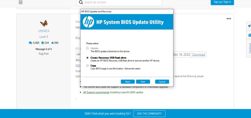

08-23-2022 04:16 PM - edited 08-23-2022 04:18 PM
Hello @drubixcube
First you will update your system configuration ...
(1) Update BIOS
HP Notebook System BIOS Update (Intel Processors) | F.56 Rev.A | 19.0 MB | Dec 18, 2020 | Download |
Why should you install the update ?
https://support.hp.com/us-en/document/ish_4123786-2338478-16
Quote: "
Updating the BIOS is recommended as standard maintenance of the computer. It can also help resolve the following issues:
- An available BIOS update resolves a specific issue or improves computer performance.
- The current BIOS does not support a hardware component or a Windows upgrade.
- HP Support recommends installing a specific BIOS update.
(2) Reboot
(3) Let BIOS be installed until it's completely done !
(4) Install/Update
HP Consumer Desktop / Notebook PC ME Firmware Update | 2020.1.0629 Rev.A | 33.8 MB | Jun 29, 2020 | Download |
Intel Chipset Installation Utility and Driver | 10.1.1.37 Rev.D | 3.5 MB | Nov 14, 2016 | Download |
Intel Dynamic Platform and Thermal Framework Client Driver | 8.2.11000.2996 Rev.D | 14.4 MB | Nov 15, 2016 | Download |
Intel Management Engine Interface (MEI) Driver | 11.6.0.1032 Rev.D | 78.8 MB | Nov 15, 2016 | Download |
(5) Reboot
(6) Check windows <device manager> for camera
(7) Please report your results
08-23-2022 05:10 PM
Hello @drubixcube
Performing the BIOS update is a bit more difficult in this case. Please skip that.
--->>> Please continue with the next steps ...
