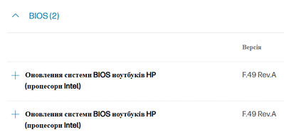

I do have latest bios, and there is no EC driver on the webpage
