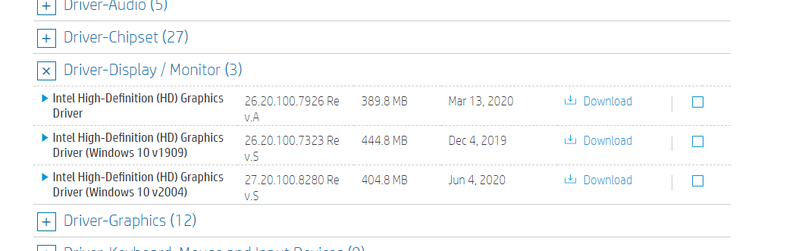

HP drivers.pngIs this a different display driver to the ones shown in the link?
https://support.hp.com/gb-en/drivers/selfservice/hp-14-ck0000-laptop-pc/20395790/model/24434436?sku=...
Intel High-Definition (HD) Graphics Driver (Windows 10 v2004) - doesn't work.
So I've installed Intel High-Definition (HD) Graphics Driver (Windows 10 v1909) - which hasn't solved the display size issue, but I have at least got the external display facility back.
