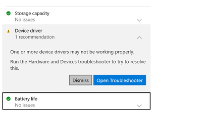

Actually, there is no option as HID-compliant touchscreen, all I can see is a 12c hid device with an exclamation(in device manager), I guess that somehow went missing.
I tried updating windows and then when we restart for the update to be installed the issue was solved. When I switched off the lap and then turned it on for successive use, the issue appeared again.
I tried the BIOS update, but the issue still persists.
Also in the windows defender security center in device performance and health, it says the 12C HID driver isn't working, but the built-in troubleshooter couldn't fix the issue.

I tried updating it and then the issue was solved with hid showing no issues in device manager and also the properties of pc displaying that it supports touch. I even tried a recovery and when the screen switches on after the process the issue seems fixed. But then after a restart the following issues arises:
>touch not responding
>12c HID having issues
>in the properties it says it doesn't support touch
>in the device manager and health report shows a device driver issue
the troubleshooter didn't fix the issue
Thanks for ur time🙂it has changed to "no pen or touch"it has changed to "no pen or touch"
troubleshooter couldnt fix the issuetroubleshooter couldnt fix the issue

The issue was fixed when I changed the system configuration to normal startup, but is this a recommended option?
Every time I restart I find the configuration changed to the selective one.
