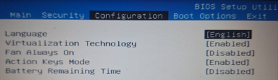

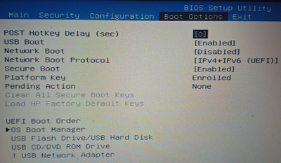

Okay, I was able to get into the BIOS menu.
Under "Configuration", I did not see anything unusual:
The only USB-related setting was under "Boot Options".  The "Network Boot" is disabled and the "USB Network Adapter" within the boot order has an exclamation point in front of it, apparently indicating it is not active or not available (???).  Unfortunately, I was not able to switch it to 'enabled.  Could this be related?
Thanks!
Hi @Kayakman19
Thank you for the update—really appreciate the time you’re putting into this!
Great job navigating to the BIOS. The USB Network Adapter under "Boot Options" typically affects network booting, not display output, so it’s unlikely to be the culprit here.
