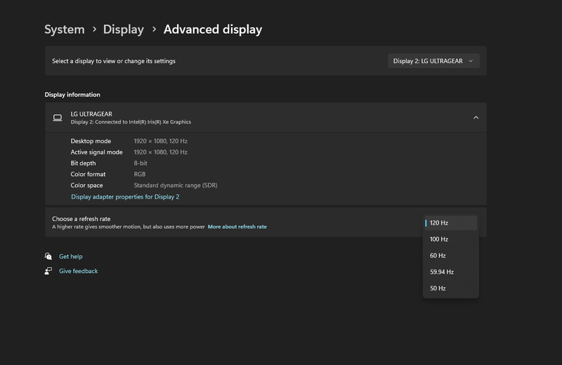

Screenshot 2023-11-26 213005.pngScreenshot 2023-11-26 212449.pngI have bought a new 144hz monitor to connect to my laptop (HP PAVILION GAMING LAPTOP 15-DK2010NX (5C1REA)) using an HDMI 2.0 cable the problem here is that the 144hz option does not seem to show it maxes out at 120hz. note I watched a lot of videos about this problem covering basic troubleshooting techniques but all of them did not work, i also checked that the monitor HDMI port supports 144hz in HDMI. I talked to Microsoft I and Intel about this problem and all of them said I need to go to the HP support team. Should I try connecting it using the display port instead of HDMI using type-c alt mood as I found out that this PC USB-C supports dp 1.4  or it will not make a difference?

I can see on your screenshot that your monitor is connected to the integrated GPU (Intel iris) of your laptop and not the dGPU ( nvidia, radeon,...). As the intel iris is way less powerfull, it shows that it can only render 120hz max... To see if the hdmi input is connected to your dGPU open the nvidia control panel and go on "physiX", there you can see which input is connected to your NVIDIA. If the hdmi is shown, there must be a setting that can be done to target the dGPU in "Display adaptater properties for display 2".
