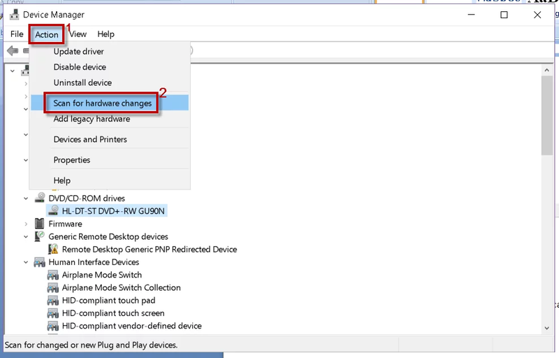

Hello @boboskee
(1) Go to windows device manager and uninstall the touchpad device and confirm.
(2) The click menu 'Action' and click 'Scan for hardware changes'
(3) Then look for (unknown) devices with an exclamation mark and send me the hardware ID.
Please report your results
best regards
