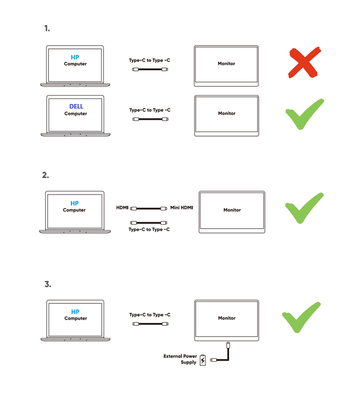

I have an HP Elitebook 830 G11 (2 Thunderbolt™ 4 with USB Type-C® 40Gbps signaling rate (USB Power Delivery, DisplayPort™ 1.4)) and I'm trying to connect a USB-C portable monitor.
With no external power into the laptop and no external power into the monitor I should be able to connect a single USB-C cable between laptop and monitor, but it doesn't work. The monitor fires up but states no signal, the laptop doesn't detect a display but eventually gives me a message along the lines:
"The last USB device connected wasn't recognized" and in Device Manager under "Universal Serial Bus controllers" I have a grey icon "Unknown USB Device (Port Reset Failed)".
Interestingly it works fine with the same setup on my Dell Precision laptop.
Please see attached image for scenarios tried and results.
I suspect my HP isn't supplying enough power out of the Thunderbolt ports.

I don't have another USB-C monitor to test with. I do have a USB-C dock that can have a HDMI and/or DP monitor connected, but the monitors and dock need external power.
Any ideas or solutions would be greatly appreciated.
