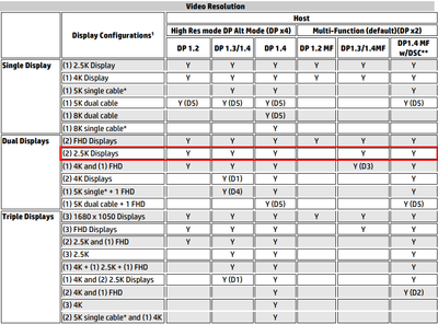

I've found this table in the Quick Specs [2] of the dock:
2.5K = 2560 x 1600 or 2560 x 1440
What dose the Multi-Funktion DP versions mean for my setup?
So my question is, is this a problem of the Notebook or of the Dock?

Additional Information from Quick Specs:
http://h20195.www2.hp.com/v2/getpdf.aspx/c06424517.pdf
 So there is no Information that you have to enable the High Resolution mode in BIOS to use that setup.
