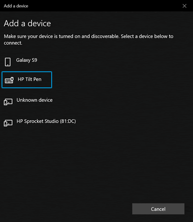

  • Select the HP Tilt Pen.
In Add a device selecting HP Tilt Pen
