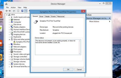

Hello  Echo_Lake, the problem with the Touchpad started again it's not working. Please what's the cause of this problem? 😞
I attached a picture of the event shown in device properties
