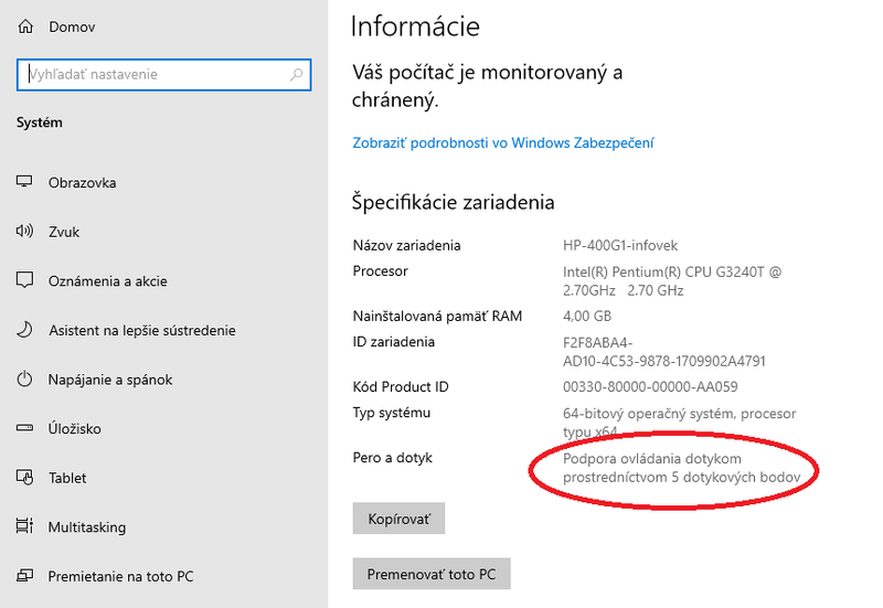

After upgrade to Windows 10 the touchscreen not working. In the computer properties is option/property/info showing Computer with touch screeen - Five fingers. What s the problem?

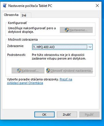

- after manually  installing HP Touch Filter Driver for 400 G1  (Release date: May 25, 2017) yellow triangle /  yellow exclamation mark for HID Compliant Touch Screen in Device Manager
I am attaching print screen:
Tablet PC - Settings not enabled
PC's info - 5 touch points
