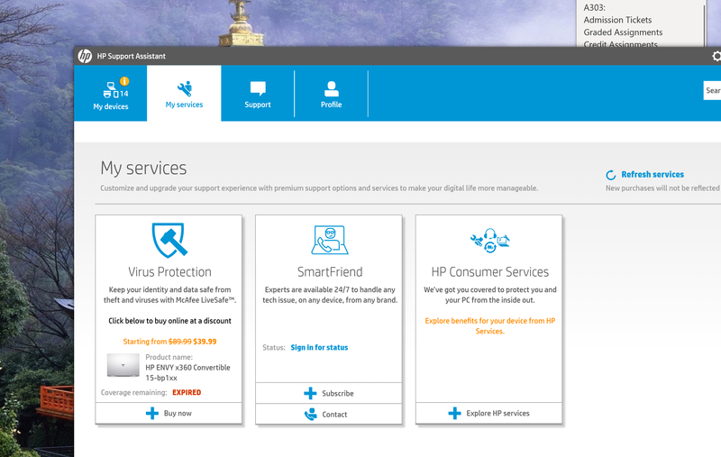

When I have some software open, there are always some vertical shadows on the screen.When I have some software open, there are always some vertical shadows on the screen.

There was no issue in the BIOS screen. The issue has existed for several months. The display on the external monitor functioned fine without issue.

I did that but the issue still exists.
