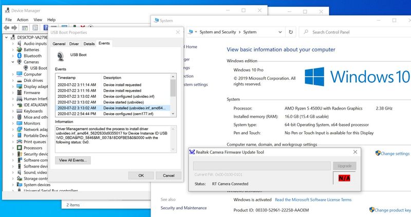

Would you have the firmware update for device ID  VID_0BDA&PID_5846 ?
I do have a USB boot issue as well on Realtek camera on a Probook G7 445
Thx

Did you find the firmware update for USB\VID_0BDA&PID_5846 ?
