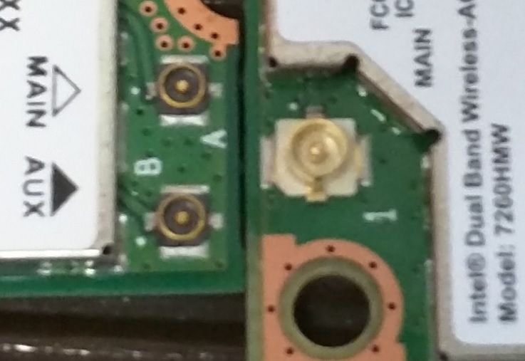

Yeh, exactly that, I'll post a picture up later but the one I've ordered off ebay is never going to fit onto the wireless card.
Here is a picture to show the size difference. Right hand is the existing, left the new antenna.20180119_082145z.jpg
Hmmmm...never seen one like that but it took the comparison with the right one to get the picture. Apparently and I had never noticed this there is a difference between the connectors for older mini-pcie and newer NGFF cards. I will figure this out and find you the antennae you need. Generic ones can work well so I will search there, too.
HP Part number:
Antennas (includes wireless antenna cables and transceivers) For use in models without a touch screen 749638-001
Yours is mini-pcie so the brass connector points are larger in diameter than the ones for newer cards and the antennae are not interchangeable.
NGFF on leftNGFF on lefto

Thanks for all the help Huffer, I'm based in the UK so was hoping to get one from there if possible, struggling to find anything on ebay from the part number you have provided.
Do you think these would be suitable ?
https://www.amazon.co.uk/Pair-Antenna-Laptop-Wireless-Internal/dp/B00DOTLJHW
Yes they will work fine. You may have to figure a way to hide some extra cable length but that will not hurt anything just roll it into a coil don't bend or pinch it.
