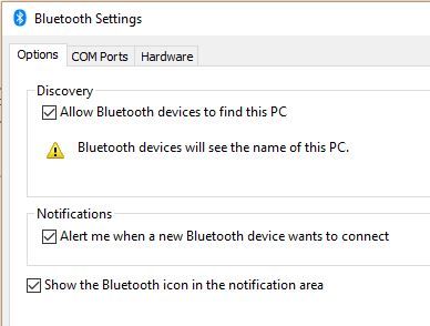

Re. your other suggestion, I can’t “delete the Bluetooth device in question from the list” – my laptop has no devices shown.
But I think it’s set the way you suggest – please see pic below.
OK, have done all that, but all is sadly as before - except that my laptop, "Fred" now appears on my phone when I do a scan. However, it doesn't respond to a pairing request.
