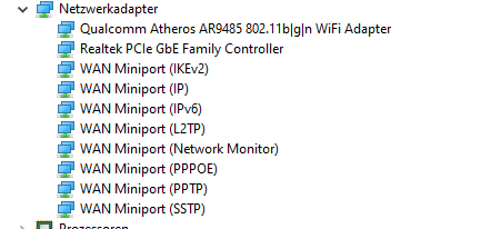

(2) Send me a screenshot of the windows device manager list of "network adapters"
(3) Send me the Hardware ID of the wifi device that is causing problems:

Ok, the product number is: B6M85EA#ABD
The other stuff is in the screenshot. However, I don't know what exactly causes problems. I guess the WLAN adapter or some settings - but what do I know 😛

Hello @ChrisTimtom
Is driver version 8.0.1.342 Rev.A or 10.0.0.318 Rev.B installed ?
Please check, I guess it's visible on your tab 'treiber' = driver (english) ?
