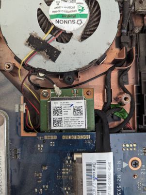

Hi Paul. I've opened it up. Photo attached. What do you think? I actually don't care about Bluetooth at all. Just want quick WiFi connection so wouldn't care if I had to choose. Not keen on too much messing about as I'm not that confident. Thanks for you help.

OK, if you can live without BT and a possible degradation of the Wi-Fi reception, you should be able to install either one of these cards:
Intel Dual Band Wireless-AC 7260 802.11 ac 2x2 Wi-Fi + BT 4.0    HP Part # 710661-001
Broadcom BCM4352 802.11ac 2x2 Wi-Fi + Bluetooth 4.0 combo   HP part # 724935-001
You should be able to find either of these cards on eBay.
Search by the HP part number, not the model of the wifi card.
When you get the card, attach the single antenna to the Wi-Fi card's 'Main' antenna terminal, not the 'Aux' one.
