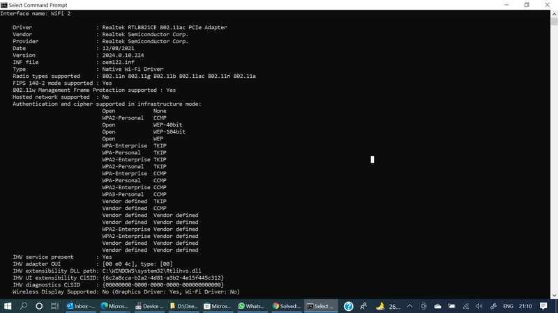

And here is my cmd screenshot. Since I am not a comms guy, i cant decipher it but it seems like all bands are supported. Still why the issue?Screenshot (6).png
Hi:
The card definitely supports dual band wifi and since it isn't working, it must be defective.
The problem is, you can only replace that card with the same model because your notebook only has one antenna wire and the other dual band wifi cards require two antenna wires in order to work properly.
The RTL8821CE card is designed to work with only one antenna wire.
