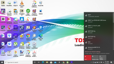

it just happened when i opened up my laptop a few minutes ago but this time I took a screenshot
here's what it looks like normally
here's what it looks like when the wifi is disconnected
it appears that the wifi option is gone
