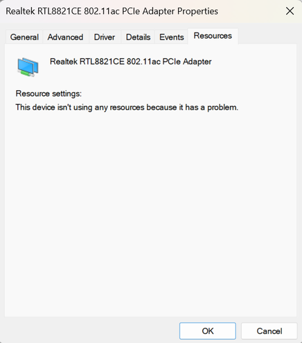

Hi Jos1,
I followed your instructions and once I clicked Restart Adaptor, it can never be enabled again.
The Adaptor icon in "Device Manager" also changed.
See Device status:
I clicked [View All Events] and this window appeared:
I highlighted all the Events and copied them as text, saved them in https://pastebin.com/BCrxU9k3
Back to "Device Manager"
I used an external USB-C Network Adapter to access the internet for this option
No update for the Adaptor
Edit:
After restarting my laptop, the WiFi adaptor completely disappeared from "Device Manager"
