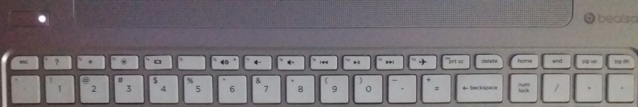

Wireless capability is turned off
I did not have any hardware button that can Turn Off/On wifi device on my keyboard, see below image for example :keyboard_layout.jpg
I never turned off the wifi physcal device directly or from BIOS.
Tried the "f12" Airplane Mode also, that also didn't help.
