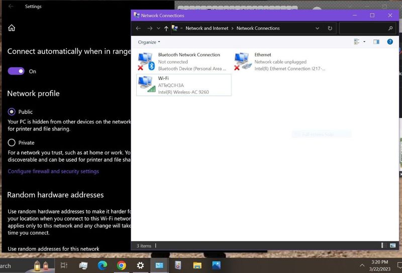

I just tried again to do the wifi unplugged it & I'm on wifi again...
Trouble is it never lasts. I keep hoping somehow its some setting but at one point I will have to give that up.

Says 9260 AC is working properly but
I have this under details that it needs further installation..What does it mean?
Device PCI\VEN_8086&DEV_2526&SUBSYS_00148086&REV_29\6&12756007&0&000800E6 requires further installation.
