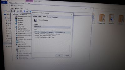

Please post the hardware ID for the Network Controller device.
Use this guide for how to find the hardware ID for a device...
https://www.howtogeek.com/193798/how-to-find-drivers-for-unknown-devices-in-the-device-manager/
 PCI\VEN_10EC&DEV_B723&SUBSYS_81C1103C&REV_00 PCI\VEN_10EC&DEV_B723&SUBSYS_81C1103PCI\VEN_10EC&DEV_B723&CC_028000
