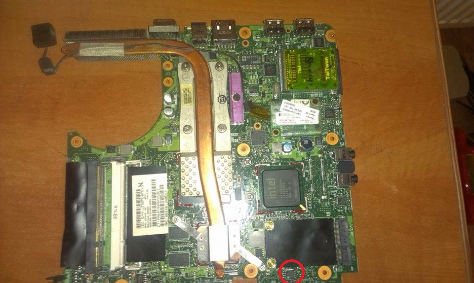

hey, can you tel me where is the chip from bios on motherboard from hp 6730s

For dispelling the myth that this can be solved by a software crack from the web. I have download the service manual from the HP site and found that the tiny 8 pin SOIC chip is not recommended as a user replacement part but there is probably sufficient information in the service manual to allow you to dismantle the 6550b down to where you can access the chip. Your photo is worth a thousand words.
If anyone knows of a service shop in Melbourne Australia which carries out this procedure for a hours labour or if this can be resolved by HP remotely I would be grateful if you could post a reply.
I have access to an electronic workshop with professional desoldering and soldering tools, antistatic mat and wrist band. The HP service manual also suggests you need the following tools, Flat-bladed screwdriver, Phillips P0 screwdriver, Phillips P1 screwdriver, Torx T8 screwdriver. S the chip is still available I may try this but it will be at work rather than a DIY project.
