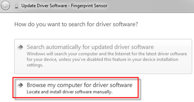

Right clik ' Fingeprint Sensor ' and choose ' Update Driver Software... '
Select ' Browse my computer for driver software '
Double check that you have checked ' Include subfolders option ' and click the ' Browse ' button
Browse to path where is the extracted file with the driver for fingerprint reader
Click on ' Next '
You will be informed the the driver was installed with success.

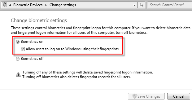

On left side choose ' Change biometric devices '. Check is everything set there like on the below picture

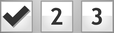

Enroll three times your finger. After every successful attempt you will see checked symbol
When the process will end with sucess then the finger color will change to this which you on the below picture.
