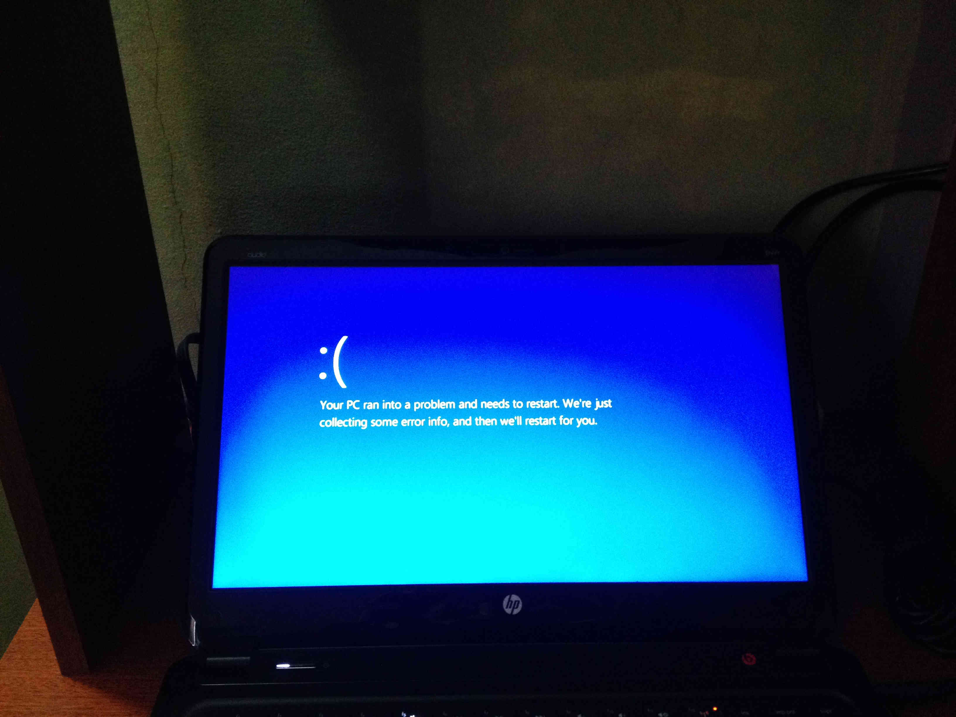

Good morning or evening everyone, some time I have been looking for the driver (ACPI \ HPQ0004 \ 3&11583659&0), which is the sensor accelerometer, but can not find it, and those who downloaded which are similar ago, making Windows 8.1, x64 , break to start ...
I would appreciate if someone has a similar team, and you were able to configure and install this driver.

Thank you for answering back, again today I have started to review and execute each step that describes me, to try if I have luck.
As I leave a screenshot of how the device appears on my computer:
Also describes the steps that tells me:
Finally already installed:
I was having to restart the computer get results ... I hope it's good.

Unfortunately it did not work .... 😞
At this point I think it is due to a hardware error ... I expect Windows10 has come, if perhaps it is corrected, which I doubt ...
