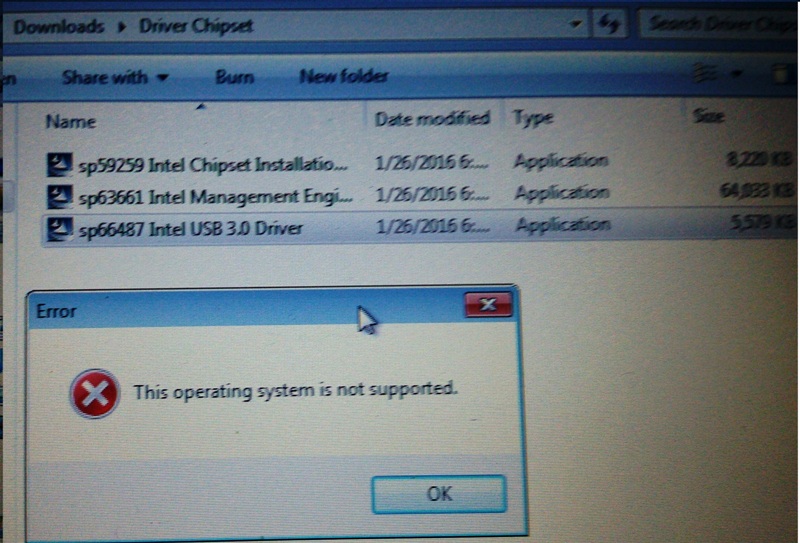

Dear Sir,
Yes same. i also trying to install Intel USB 3.0 Driver (International)  on the below link under section "Driver - Chipset". But It gives error - "This Operating system does Not Supported"
and many times as - "This computer does not meet minimum requirements for installing  the software"
Thes two USB 3.0 Ports working well in Window 8-64Bit. but i need OS Win7- 32Bit. Also images for error attached here while installing in Window 7 Ultimate 32Bit.
http://h20564.www2.hp.com/hpsc/swd/public/readIndex?sp4ts.oid=5212910&swLangOid=8&swEnvOid=4055

Sir,
Still Same error  "This computer does not meet minimum requirements for installing  the software".
