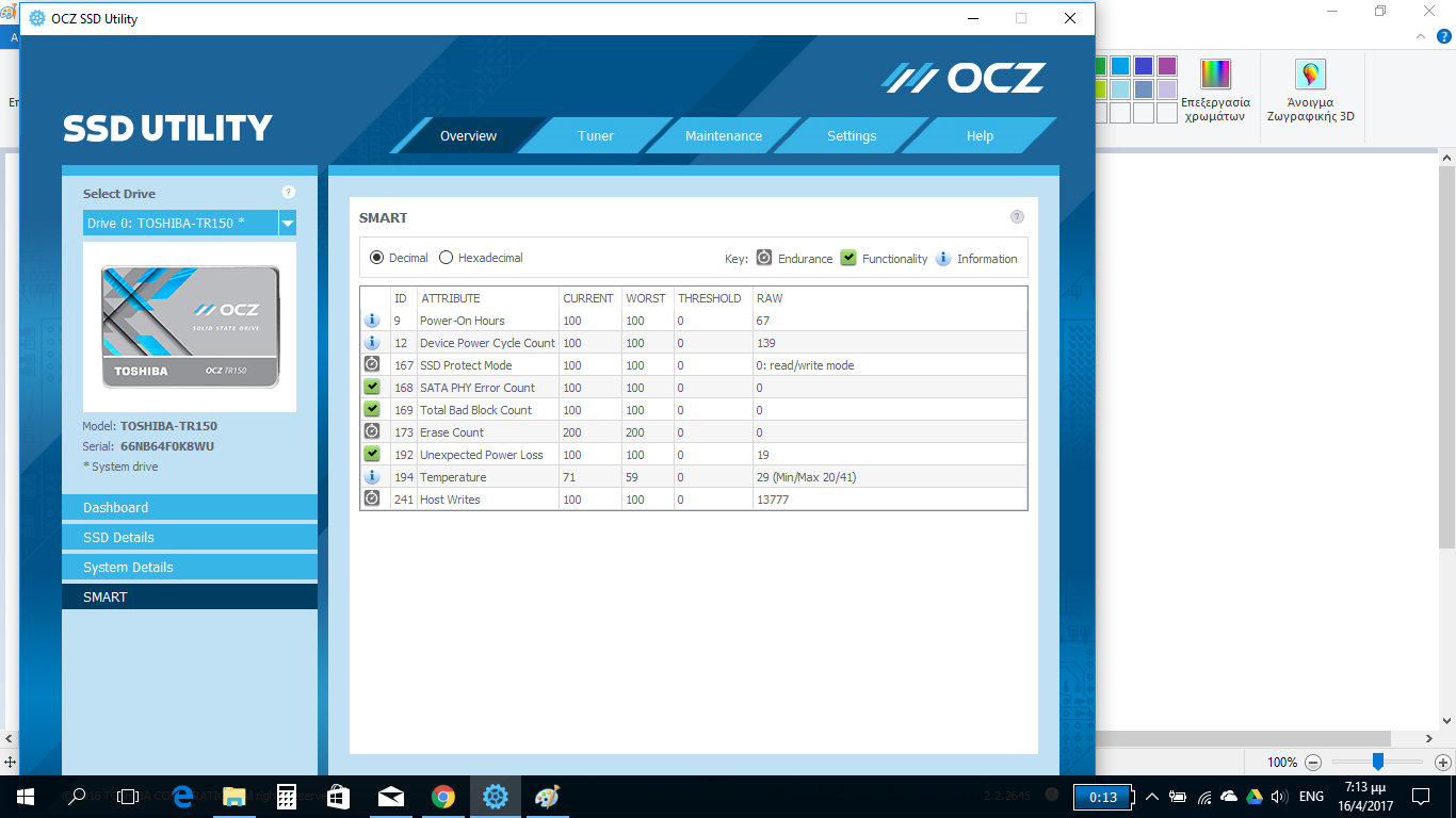

I do not have a Toshiba SSD to test and use the Help menu. You do. Click on the Help tab to see what the diffferent attributes mean.
I have Samsung SSD and when I run the SMART utilities, I do not get readings like those.
Normally what I see on spinner and SSD utilities for current and worst numbers is  below a given threshold number, which means all is OK. The utility screen you showed does not even show a threshold number that makes sense.
Click on the Maintenence tab to see what is there.

I found a manual for the the Toshiba SSD utility. It should help you.
https://ocz.com/download/software/ssd-utility/SSDUtility_UserGuide_English.07112016.pdf
As long as there is not a warning icon to the left of the ID field next to the attribute, it means that there is no issue present.
SOLUTION
Change the disk !!!
I put the OSZ to my desktop and use the Desktop's Kisgston (SSD 240 ) to my Laptop .Now everything is fine . Obviously there is no combatibility between OSZ TR150 240GB and Elitebook 8470p .
