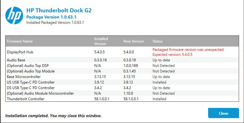

However, now the HP Support Assistant keeps asking me to install the update again and again. I have captured something strange that may explain this. I wonder which version others have;2020-09-26_HP-Thunderbolt-Dock-G2-Versions.jpg
For some reason, it appears that the update tries to go back on the version of the DisplayPort Hub from 5.4.0.5 (my current version) down to 5.4.0.0 and it fails at that.
HP -any hint?
