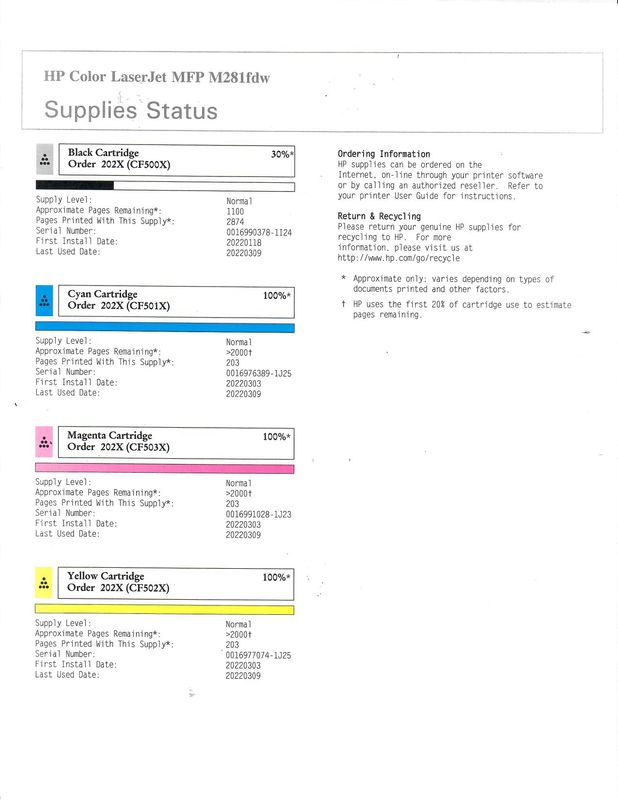

Hello @ciairrah ,
Welcome to the HP Support Community!
Print the supplies status page (see Manual)
1. From the Home screen on the printer control panel, select the Setup menu.
2. Select Reports.
3. Select Supplies Status.
upload here, click on the icon "Insert photos", "Set format = Large", original size at least 200 KB.
The black ink is a bit low, but I'm not having an issue with the black ink fading.

Indeed, the colors (printout, 2nd image) are not OK.
But the accessory status printout already shows that the colors (all) have a problem with intensity!
