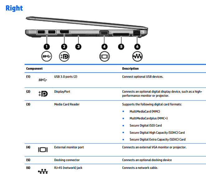

Accroding to the data sheet and every review I've read for the Folio 9470m it's supposed to have an SD card reader between the RJ-45 jack and the VGA adapter.  On my computer there is a large slot there, but it's not an SD card slot.  What is it and why doesn't this computer have an SD card slot?  It's one of the reasons I chose this model, so it's a bit disappointing.

Is this what it look like?
Here is from the Manual:
The card reader is actually one position toward the front (Item 3) and is well under the laptop. The big slot you are looking at is for a docking station.
If this is "the Answer" please click "Accept as Solution" to help others find it.
Many  thanks.  I looked at that spot many times and didn't see the slot because there's a "filler" in it that fits really closely.
Thanks for the tip. I also never noticed. But I have attempted to remove the cover and it doesn't come out. Any suggestions?
Push it in. It is spring loaded
Yes I gathered that because my old machine had the same. So I think that this one is broken because it clicked but stucked inside. I guess it's broken.
