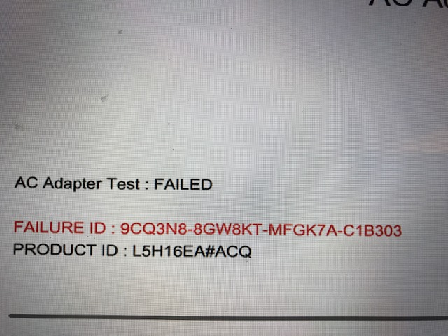

David, it worked for a while, and then stopped. I have run the adapter test and it failed. What do I do now? Where can I buy an adapter in Johannesburg? for an HP X2?AC Adapter failure
Hi,
You can probably find a universal adapter if you go to large electronics store.
If you search online for the exact model of your PC you will find the adapter.
If you post the exact model of your X2 I can see if I can help with the online search, even though I live in Italy.
