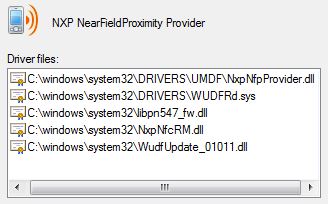

Below is the drivers details of a laptop that has the device working properly
I hope this will help
Thanks
