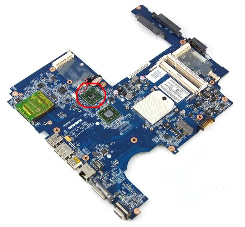

I agree with qjuantum. After I posted here, a day or two later the laptop failed to boot again. So I reseated that other chip, and the laptop is back up and running fine. This is the chip being mentioned:
 http://i18.photobucket.com/albums/b115/Imagerat/dv7_chip_zps0cf961ad.jpg
pcgal03, I describe the method here. I now apply heat after the solder is melted to at least a 20 count. Be sure to remove any plastic sheeting from the board before you begin (don't want a melted goop). If someone can do their own repairs, by al means go for it. I don't want to turn this into an ad opportunity, but I will mention I am in Upstate SC.

Did you guys not read the thread? There are some of us that just reballed the I/O controller chip and the issue was fixed withouth the need to purchase a motherboard. That is the easiest, more cost effective solution to this problem. Just look a few posts behind yours.
