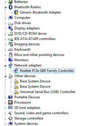

Here is a screen from my Device Manager:

You need these drivers for the devices in your screen shot.
Base system devices...

Now, I see what I hope is just a minor problem...You don't have a wireless network adapter showing up anywhere in the device manager...with or without a driver.

Yes, there is no Network Controller in device manager.

I forgot that it can't be missing, because your screenshot indicated the presence of a bluetooth radio that needed a driver.
The bluetooth radio chip is on the wireless card's circuit board.  So the bluetooth would work with the right driver installed.
