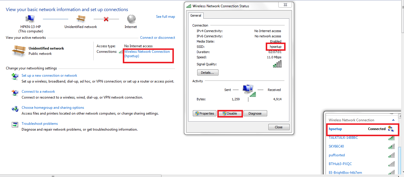

Issue:    “HPSETUP” appears in wireless connection manager
Causing “HPSETUP” to Hijack and cause interferences with my Wi-Fi Connection
Can Please someone help me.
Hewlett –Packard: HP G72 Notebook PC
Window 7 Home Premium 64-Bit Operating System
Processor: Intel® Core™ i3 CPU M350 @2.27GHz
Memory (RAM): 4.00GB (3.80 GB usable)
I have a HP G72 Notebook PC and to access internet I use a Wi-Fi connection.
My connection was fine and stayed excellent for a long while.
Now I struggle to get online or I cannot get on line at all.
In my “Internet access” section (Small click Bottom Right of my screen” I can see several other Wi-Fi access point wish always been there and never caused me problems to connect t and access the Web.
None of them are problematic except the one that causing me grief: The Wi-Fi connection “HPSETUP” is there and over rides my usually fine working connection.
It causes my connection to fail and let appear a small “Yellow Triangle” with a small black exclamation point sign in it.
Some time it goes, sometime it stays and as long as it’s there my usual connection is like dead.
Please how do I solve this problem, how do I erase this Wi-Fi connection “HPSETUP” all together.
I do not have a wireless printer and I went true most step by step procedure and troubleshooting to: repair/correct/solve my connection but none of them was useful or working.
Any ideas or suggestions would be greatly appreciated!  Thanks
Please help is really required as the problem being so much a pain and recurring for so, so long without solution that it left me thinking about changing my Laptop for something that doesn’t have this connection problem.HP G72 hpsetup wireless problem.PNG

1K) Hpsetup Wireless NetWork Connection Manager.PNG2K) Hpsetup NetWork and Sharing Centre.PNGhpsetup Unidentified not connected set up General.PNG
If i try to disable it, what it does is swith off my entire Wi-Fi and nothing is visible in my network, note that
I also have in my Network Adapters 2 things:
-       Microsoft Virtual Wi-Fi Miniport Adapter
-       Ralink RT3090 802.11b/g/n Wi-Fi Adapter
Are this 2 supposed to be there together or are they possibly conflicting with each other causing this problem.

1)      I did not make any changes to wireless connection prior to this "hpsetup paradox Ghost Wi-Fi" issue
2)      This “Hpsetup” (so called available Wi-Fi Connection) only shows in: “Wireless Network Connection Manager” but Never Shows up in: “Manage Wireless Network” Page or in the” Network and Sharing Centre” page.
*I tried to find it in both: “Manage Wireless Network” and” Network and Sharing Centre” to try to click on it and then “choose Remove Network” if it’s not visible there I can’t of course manually remove it.
In the: “Wireless Network Connection Manager” it’s the only place where it is visible but when I click on it doesn’t give me any option to remove it. It is like a “Ghost Connection” it is there but it’s not interactive.
*I tried: “Go into Network and Sharing Centre, and then click on the left side Manage Wireless Network. If you see HPSETUP there, right click and choose Remove Network, The problem can’t be resolved that way as the “hpsetup” Network does not appear there; the only Network visible is my usual “Kais SSII”.

Dear Dragon-Fur,
 “I found a document that was a life saving help to disable "HPSETUP" (Ad Hoc Wireless Networking) in my Windows 7 machines”
Procedure:
  • Go to Start--> Search "CMD.exe".  When it is found, right click on the icon (see below) and choose the option "Run as administrator. When prompted, click Continue.
  •  A command prompt window will open up.
  • Type in "netsh wlan show filter" and hit enter. This will show current filters set in place
  • Type in "netsh wlan add filter permission=denyall networktype=adhoc" (thank you Valis) and hit enter. This creates ad-hoc blocking filter.
  • Note if you see " Error: Function WlanSetFilterList returns 5. The requested operation requires elevation" you will need to run these steps again as the system administrator. To double check if the mail filters worked type "netsh wlan show filter" and hit enter, and you will see your mail filter under the "Block List on the system"
ET voila, couldn’t find anything for ages if it wasn’t for you Gentlemen pointing theses important parameter of search to me.
So its Problem solved for this “HPSETUP” hidden, annoying Gremlins.
