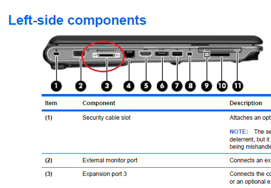

Your old machine has a docking/Expansion Port 3:
       http://h20564.www2.hp.com/hpsc/doc/public/display?docId=c01509066
and your new machine does NOT have this port.

Hi,
My sincere thanks for your prompt response to my post. I am waiting for the required cable - which is not available until next week - to try connecting the docking station to my ENVY notebook.  Once I have been able to complete the task, I will comment further; in the meantime, I am once again grateful for your prompt response.
