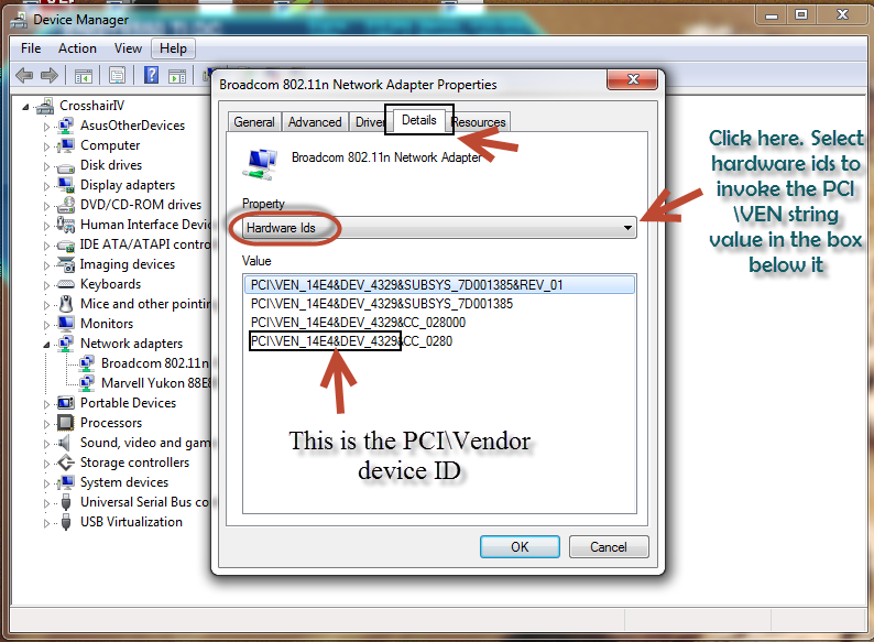

Determining what the devices are is a one at a time process. On each unknown device or device without drivers, right click on the device and select properties. In the properties window select the Details tab and  hardware ids in the property  dropdown. Post the PCI\VEN string as seen in the following image for each device here in your post.  Once that is done we can let you know what the device is.

Thank you Erico for your quick reply. I followed your instruction and in one case I found the Hardware ids as:
ACPI\HPQ0004
*HPQ0004
And for another one , nothing is shown in hardware id field.
Now what should I do?
