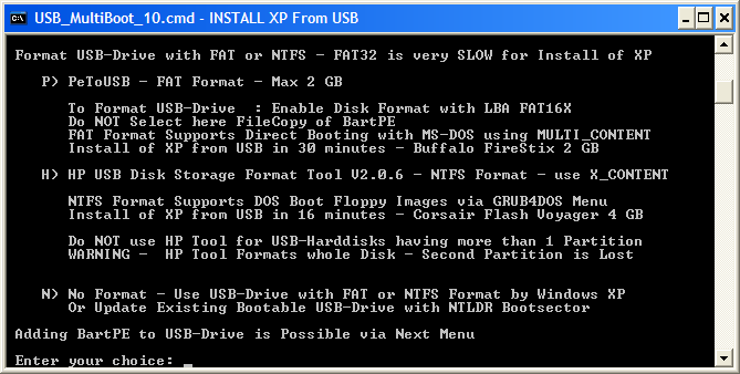

In this step you will decide how to format USB-Drive.
undefined
Select PeToUSB method by pressing the ' p ' key and then the ' Enter ' key.

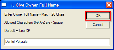

Now you will add few basic information to the Windows XP setup.
Choose ' Yes ' to start the process.

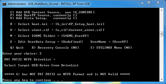

   Important information!!
  • After selecting Ok on Windows 7 you will see the information that your flash drive has wrong format just like on the below screenshot.undefinedWhat you need to do to fix this problem? Edit one file from the MultiBoot folder -> USB_MultiBoot_10. Right click it and choose Edit. At the very top you will see a line VER | find "6.0." > nul Change it to VER | find "6.1." > nul When you will do this close the file and save changes. This will allow MultiBoot to detect that you are running the script under Windows 7. If you have problems with editing the file then you may download the file which already edited from here. You only need to enter the MultiBoot folder and replace the old file with this one.

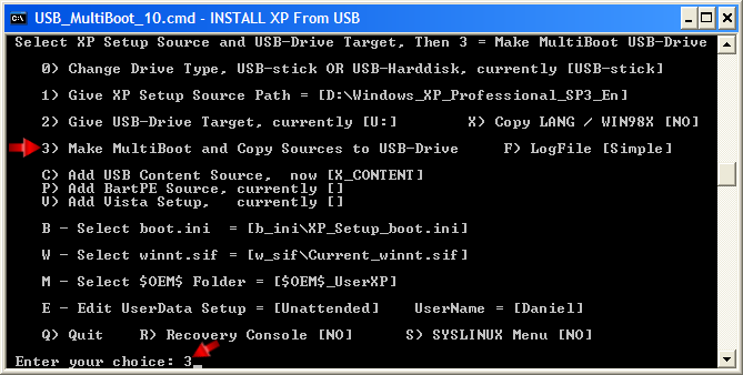

Hit the ' 3 ' key and then the ' Enter ' key to make bootable XP setup USB-Drive.
undefined
Choose ' Yes '.
undefined
Select ' Yes '.

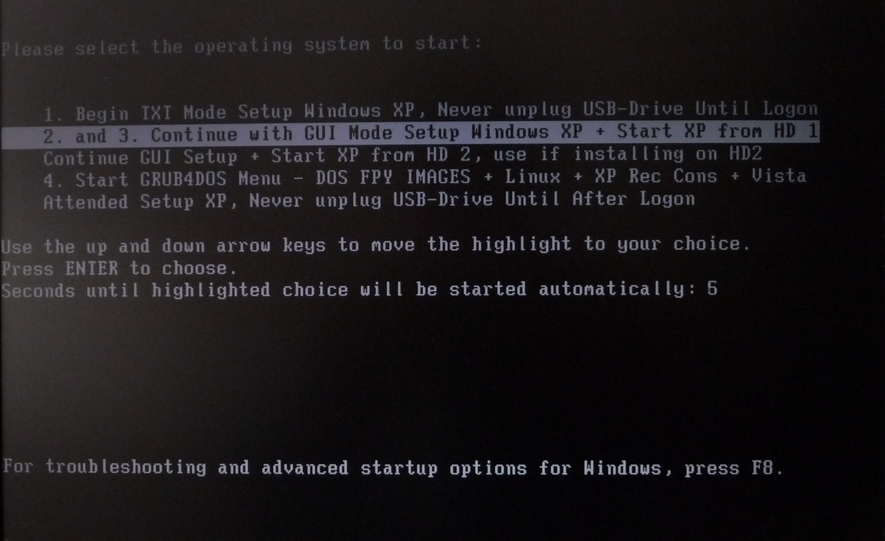

After restart you will see the start menu. Use the ' up arrow ' key to select option 1
undefined
and press the ' Enter ' key to confirm this choice.

This time select option two or don't do anything - it will be choosen by default.

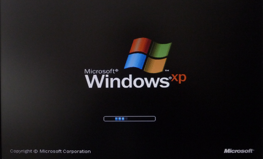

Windows XP welcome screen will appear.
undefined
Congratulations! The XP system is finally installed on your machine.
