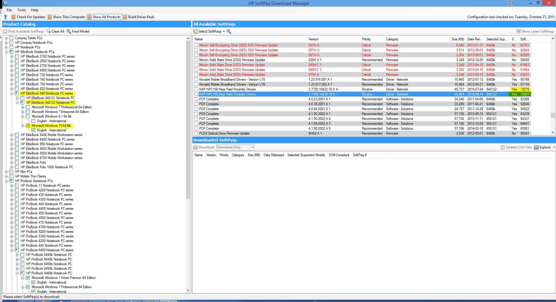

You can find the sp72075 and sp72457 through SoftPaq Download Manager. You need to go to configuration then OS option and then check Windows 10 64bit.
