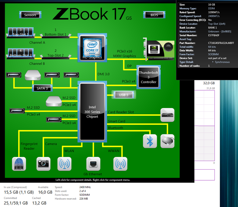

This image should give all the info:
Thanks in advance

Thanks for your reply. I am still not sure how to read that doc, does it mean that i have to install ram in all 4 slots to get the optimum speed? As you can see in my screenshots, it operates on 2400Mhz, not 2666Mhz. So what am i seeing wrong?

As I tried to say, if you install it in the wrong slots you will not get dual channel. You have dual channel. Appears you have it in Slots 3 and 4. I think you should always use Slot 1 as it says a single module must go there. Generally you would install in odd numbered slots so 1 and 3 is how I would have done it, but I really honestly do not think it has anything to do with where the modules are installed. I think you are seeing a system which runs its memory at -2400 speed.
How i installed it was in slots numbered 1 and 3 (on the motherboard), but then i got single channel 2400, so now its in 1 and 4 and i got dual channel 2400.

I just realised that the green image has confusing slot identifying numbers, so let ignore those. I was talking in the numbers written on the mb itself. One is in slot 1 and 2 is empty (these are the hard to reach ones under the shield). First i tried the second one in slot 3 then it gave single channel. Now its in 4 and gives dual.
I read gaming pc's sometimes advice to use 2 and 4 because they are closest to the cpu, but i understand from the docs the should be in 1 + 2
