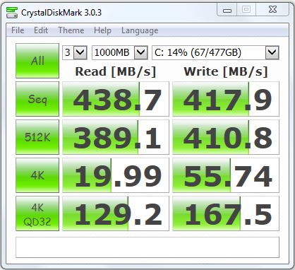

Rebooted it 5 or 6 times to be sure but it seemed fine, I even ran CrystalDiskMark to see what speeds I was getting. Here's a capture. 🙂

Rebooted it 5 or 6 times to be sure but it seemed fine, I even ran CrystalDiskMark to see what speeds I was getting. Here's a capture. 🙂http://s6.postimg.org/4l3l8bsu9/crystaldisktest001.jpg

It is definately connected via SATA III as you can see by my results in CrystalDiskMark.CrystalDiskMark.JPG
