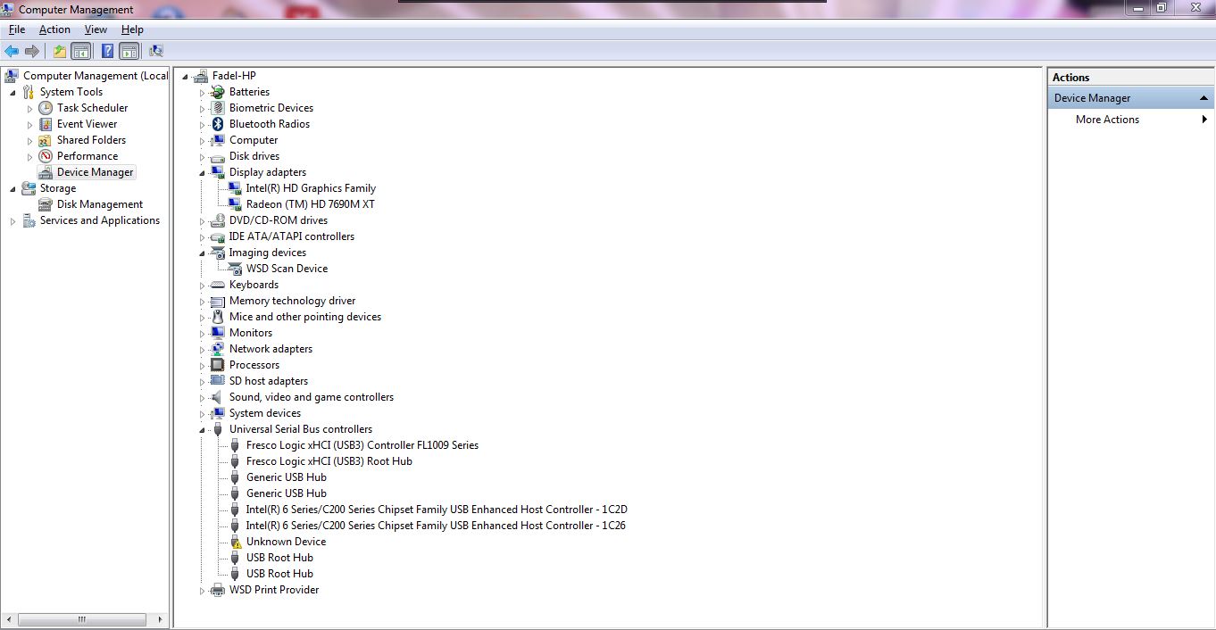

I have been experiencing the same issue with my notebook HP Pavilion dv6 Notebook PC Product Number A7P81EA#A2N Serial Number {Personal Information Removed} and the message says " one of your usb's attached to your computer has malfunctioned" it always pups off once I log in and it's very annoying. Any solution for this problem?. Thanks
But not work the usb
@Fadel914
I'm sorry you're running into this USB error. Thanks for providing your product number. Could you tell me what you see in Device Manager or even get a screen shot of your Device Manager. You're looking for any yellow caution triangles/symbols.
