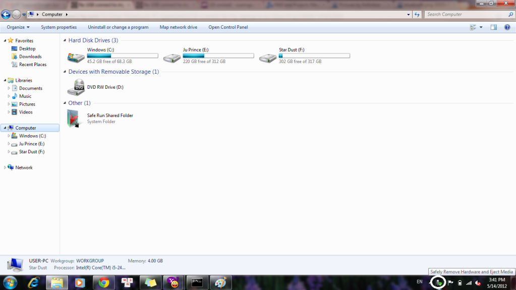

This problem still occur. Here is my screen when connect one ATA USB Flashdisk.

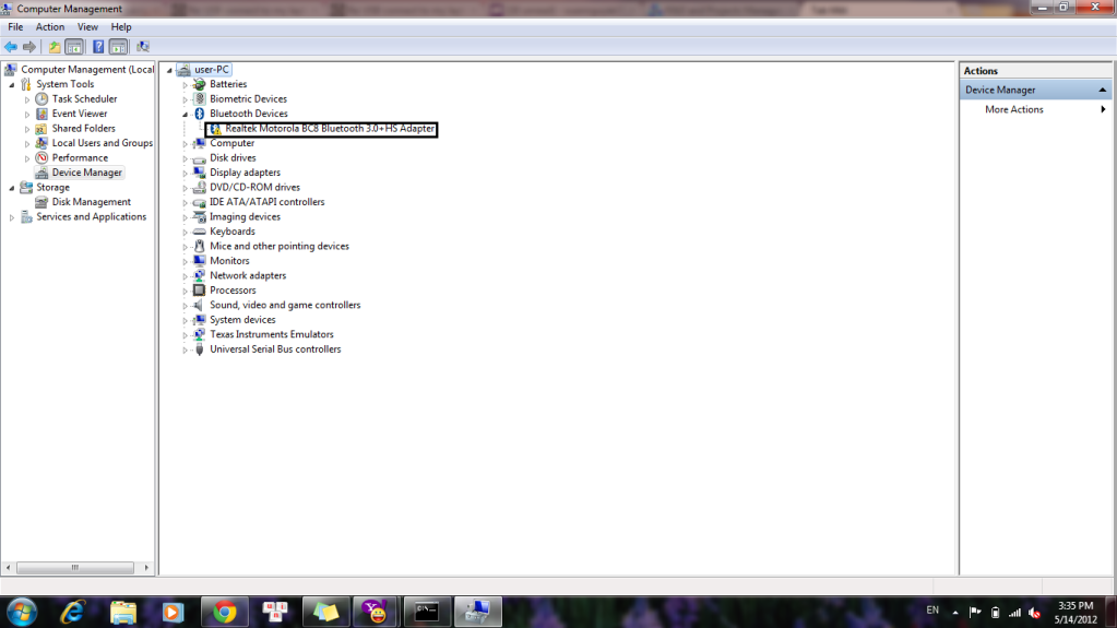

And another problem with my PC is bluetooth driver, although i update the newest driver for my bluetooth device.

It normally takes about six seconds for the Windows 7 OS to fully react to a usb 2.0 thumbdrive plugin but it takes about 5 minutes with my laptop to fully react (if and only if i do some thing like that, plugin one new HDD to my laptop through USB 2.0 port, wait 1-2 minutes and plugout, the screen "driver does not install" appear and plugin again, my laptop regconize it like the first picture above, 3 minutes later, the autoplay window appear and i can tranfer data to my laptop after that.)
