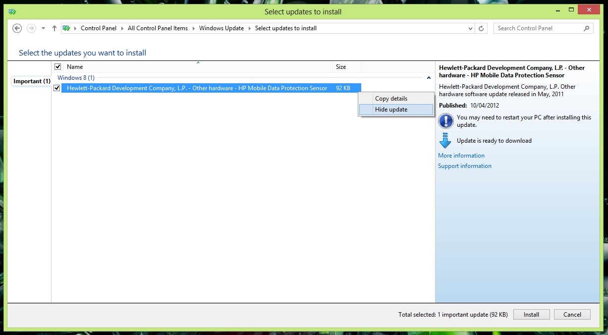

I believe I found the answer to everybodys problem, it's a Windows update that makes the driver come back from the dead. What you got to do is hide the update and that should fix the problem.
