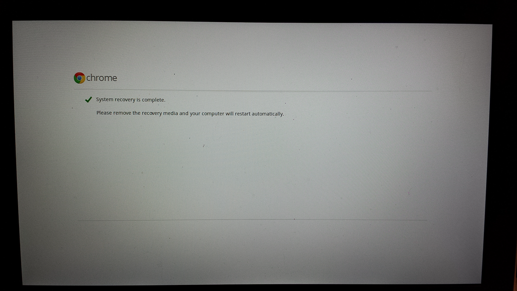

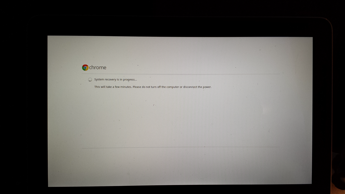

I am in the process of forcing a recovery. The first time I used usb recovery media created on a Sandisk 8GB flashdrive. It was unsuccessful, even though the media creator said it was successful in creating the media. Sandisk brand usb flashdrives are known to be problematic when it comes to recovery media creation.
I created another usb recovery media flashdrive with a 32 Gb Kingston rubber ducky usb 3.0 flashdrive. This one is working as expected.
Update: the forced recovery completed successfully. It didn't take long to complete. Perhaps three or four minutes at most.

After doing this... it gets to the next step:
Where it checks the stick and should begin the process of downloading the OS from the USB made from ChromeOS recovery... I then get the message:
An unexpected error has appeared. Tips for repair can be found under the URL:
google.com/chromeos/recovery
I had done this about 15times in 2 days... now it doesn't recover...

Amazing... I loaded an SD card (Scandisk) and it didn't work. Didn't work after having it reformatted either.
The I pulled out another pen drive, loaded the recovery, and it worked.
