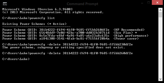

The better and more permanant method is to open Command Prompt and type "powercfg list" and it will show you a list of all your powr plans.
Then type "powercfg -delete 88888888-8888-8888-8888-888888888888" replaceing the 8's with the corrosponding GUID that it lists for you.
If you make a mistake it will say "The power scheme, subgroup or setting specified dose not exist." otherwise it will return nothing on completion as shown below.
Hope this helps.
