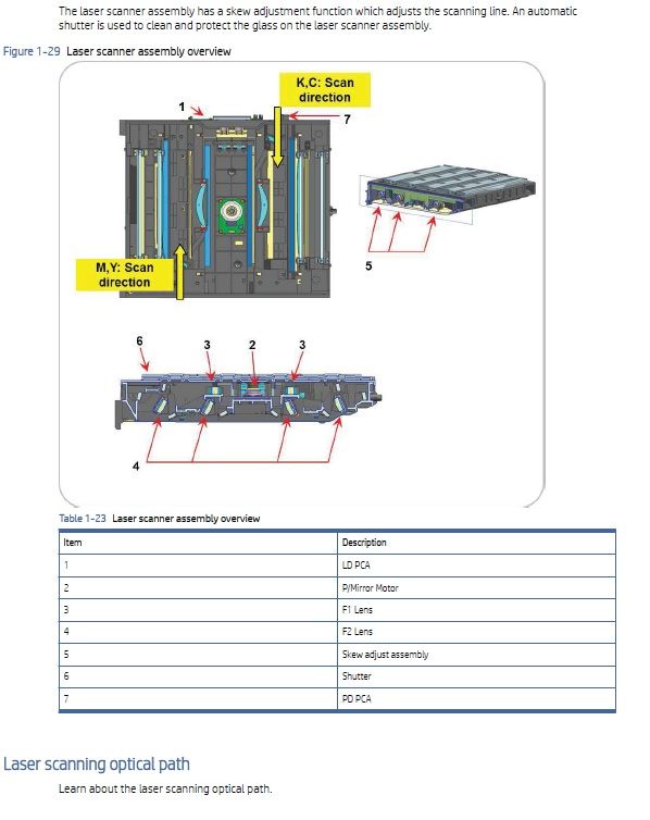

I think the problem is with LSU. Paper feed is LEF.

It could be LSU or HVPS.
I am not familiar with the construction of LSU on that printer model, but is it possible to open a LSU and swap laser and electronics C that has a defect with M without defect. That will confirm that LSU is the problem.
My profile on LinkedIn
Thanks for the information.
But LSU can't be disassembled. It's the whole unit. I  know, that this problem may be also assigned with HVPS.  But i can't order two parts
Isolate the contact on the C drum, which will make the printer print the full page in C.
Cover the C laser to prevent laser exposure to the drum. print a page, if the printed page is in full C without stripes the HVPS is probably OK then replace the LSU, if the full C page has stripes it's not the LSU.
